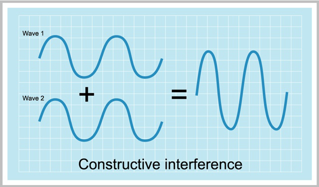

Sound is simply a vibration that spreads as a wave through air. This vibration, or pulses of high and low are pressure, move through the air at the rate of a mile in five-seconds on the average – commonly referred to as “the speed of sound.”
In an internal combustion engine, these pulses are created when the exhaust valve opens and the hot gas from the combustion chamber enters the exhaust system. The exhaust gas exits the combustion chamber under pressure and meets the low pressure gas in the exhaust pipes and stack up on each other. However, the sound waves migrate through the media without any resistance, making their way down the pipe faster than the actual gases do.
If a crest of a pulse wave meets a crest of another pulse wave of the same frequency at the same point, the displacement is the sum of the two waves. In an eight cylinder engine, you can have eight pulse waves at the same frequency at the same point creating a lot of sound.
When these pulses reach your eardrum, the eardrum vibrates back and forth which causes the brain to recognize the motion as sound. It is possible to add multiple sound waves together and get less sound by lowering the pressure pulses. This is where muffler design comes into play.

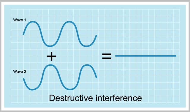

When two pressure waves have displacement in opposite directions there is an interference that occurs. This is the noise canceling effect that muffler designers use on certain frequencies to silence them, leaving only the desired frequencies.

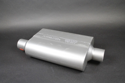

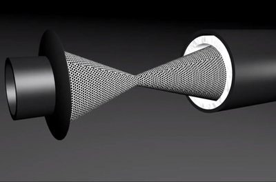

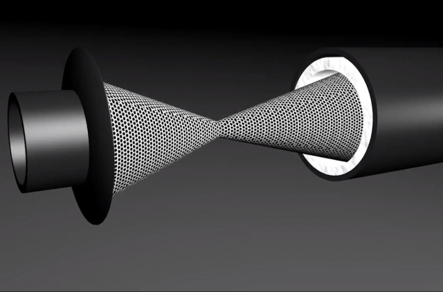

Flowmaster’s laminar flow muffler design forces the flow through two conical shaped perforated tubes before exiting the muffler. Flowmaster’s Nick Tauber explained the technology by saying, “These mufflers use what we call broad band sound cancellation. The sound waves expand to the outer core of the muffler where the sound waves are cancelled out similar to one of our chambered mufflers. Residual sound waves are then absorbed by the outer thermal barrier which also helps dissipate radiant heat. As the exhaust pulse enters the muffler its velocity is increased using the venture effect. The increased speed of the exhaust pulse creates a low pressure area behind it. This creates the scavenging effect. This type of technology also works very well in turbo applications.”

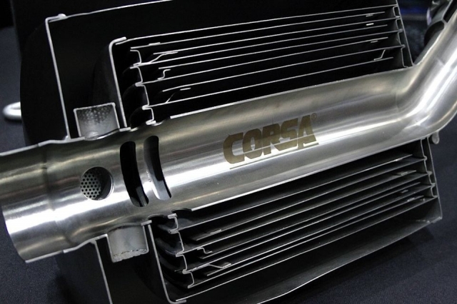

Using a unique system they call Reflective Sound Cancellation (RSC), Corsa’s Brent Noward admits that getting rid of restrictions is the key to designing a successful reactive style muffler. “With our RSC technology we target very specific frequencies and target our muffler designs to tune out those frequencies without impeding airflow.”

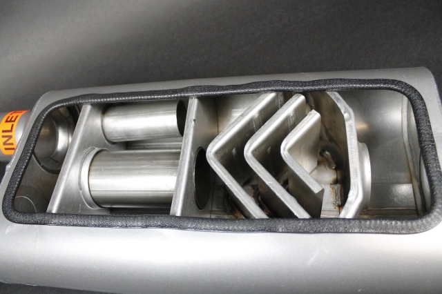

Former Indy Car racer and Midget Auto Racing Hall of Fame driver Billy Boat explains the strategy behind his company’s noise canceling concepts. “We consider two basic noise canceling concepts when designing mufflers for B&B Exhaust systems,” says Boat. “Reactive and absorption. Depending on which concept you use in muffler design, it is going to have a great impact on the tone that the muffler is going to have.”

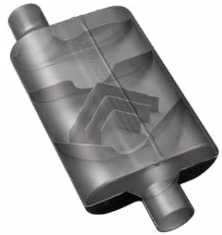

Flowmaster uses delta plates to divide the flow and bring it back together to cancel some noise frequencies.
Many reactive mufflers are designed with chambers and plates that deform the sound waves coming out of the engine. These techniques require the sound waves to bounce around and react against another pulse wave. Flowmaster takes a different approach. According to Tauber, “Flowmaster mufflers take the sound wave and splits it. When the sound wave comes back together the like frequencies cancel each other out. The mufflers also scavenge exhaust by creating a low pressure area behind the delta plates.” Basically, Flowmaster controls the sound by using chambers and exhaust flow.
The more restriction there is in a muffler contributes proportionately to the lower sound waves and the amount of engine power that is wasted. There is a direct correlation between the amount of exhaust noise and power lost. Basically, the louder the exhaust note, the more power that is retained and can be used.
Multiple reactive technologies combine to create the exact signature tone for Flowmaster mufflers.
Depending on the sound level desired by enthusiasts, “The amount of delta plates and the use of a Helmholtz chamber can change the sound of the exhaust to anything from an aggressive note to something just above stock,” Tauber explained.
Corsa’s Reflective Sound Cancelation (RSC) technology focuses on getting rid of low frequency sound waves by diverting them into specifically designed channels and reversing the flow causing the sound waves to cancel themselves out and eliminate the unwanted frequencies. “We generally try to use tubing equivalent to, or larger than, stock tubing to increase flow,” Noward added.

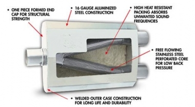

Absorptive mufflers are designed so that the sound entering the muffler interacts with packing material and is converted to heat by the frictional process. This muffler’s performance relies on absorption by the packing material for performance.
Absorptive type mufflers gained serious recognition in the late 50s by hot rodders and have continued to thrive with enthusiasts that want a very aggressive high performance sound. These straight-through designed mufflers produce a tantalizing sound and are sought after by many enthusiasts.
Enthusiasts wanting an absorptive style muffler should look to choose one from a reputable manufacturer like the ones that we have listed here. “Certain mufflers can burn out because the packing material is in contact with perforated tubes and the hot exhaust gases,” said Benty. If the packing material burns out or is blown out of the muffler, it’s ability to provide any noise control is reduced.

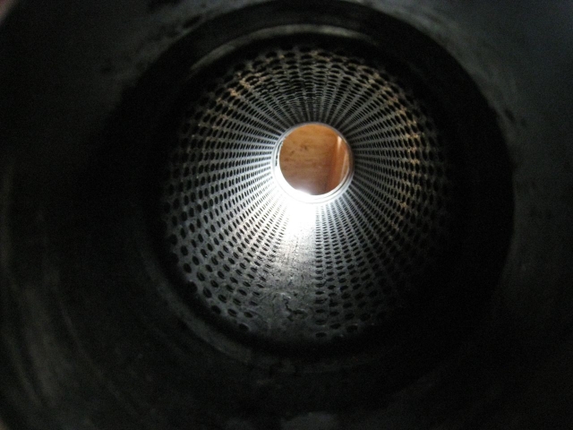

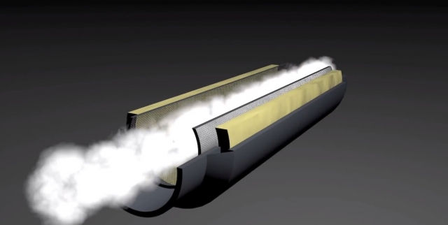

Absorptive type mufflers tend to be a straight-through style core wrapped with a packing material for sound absorption.
“Absorptive muffler technology has been around since the 1950‘s,” explained Tauber. “The problem with this technology is that even though the muffler looks straight through, the turbulence caused by the sound and exhaust pulses trying to escape into the packing material, causing back pressure.”
“The quietest time in an absorptive muffler’s life is when you buy it,” says Flowmaster’s Nate Shelton. Shelton has over 40-years of experience with performance exhaust since starting at Hooker Headers in 1972.
As Benty explained above, the packing material gets burned or blown out of the muffler. Condensation can soak into the packing material adding to the degradation of the muffler’s ability to act as a silencer. Unless you plan on replacing your mufflers a lot more frequently, or wearing noise canceling headphones when you drive, straight-through mufflers may not offer the controlled sound level that you desire.
Sound waves move to the exterior though the packing material on it’s way out of the muffler. Many enthusiasts like the sound created by this style muffler.
Noward explained absorptive muffler’s perforated tubing as being a big difference between the reactive style and absorptive style muffler design. “We don’t use porous tubing as a primary means of sound deadening as this type of methodology is generally used with a packing muffler as the primary means of sound deadening. These methods can actually impede flow.”

Noward explained how Corsa design process works with their engineers. “Our proprietary RSC technology is designed differently dependent upon the sound level we are targeting. We change our exhaust note by changing how we design our RSC technology inside of the muffler removing frequencies or allowing additional frequencies to be heard.” To Corsa, targeting the sound is primary to designing the internal parts of each muffler.

Hooker Header’s Maximum Flow mufflers utilize two perforated tubes branching off of a single entry tube to a twin exit.
