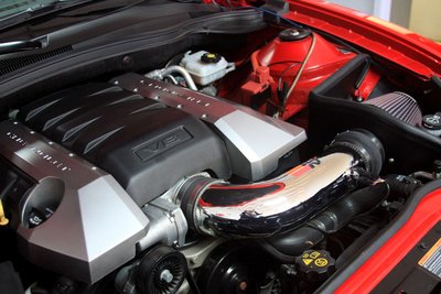

Cold air intakes have earned a reputation for being one of the best bang-for-your-buck modifications you can make to a modern V8, and for good reason. They are simple on the surface, but you might be surprised at just how much engineering and testing goes into each specific system.
The LS series V8 has enjoyed a wealth of different aftermarket parts support since its introduction approaching two decades ago, with more and more becoming available as this engine evolves. There have been heads, induction, cams, throttle bodies, and a host of other power enhancers for a wide variety of LS applications. However, a cold air intake is almost universally the first modifications that LS enthusiasts perform, and with good reason. Cold air intakes are relatively inexpensive, easy to install, and can reap some very respectable power gains.
Unfortunately, there’s a lot of choices out there, and depending on your particular car’s popularity, you may be faced with a half dozen or more different cold air induction systems to pick from, with some manufacturers offering multiple options within their own product line. How do you decide what’s right for your car or truck? It all comes down to doing your homework…
Intakes may all be meant to do the same thing - flow more air - but designs, technology, and testing can vary widely between manufacturers.

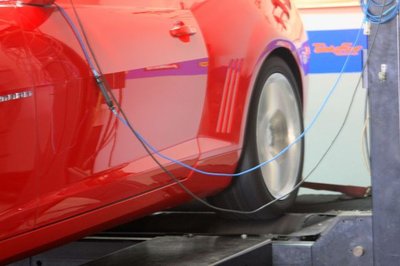

Before you make any changes, invest in a good baseline dyno test and tune by a proven professional to see what your engine is doing in box stock condition and so you can verify your own power gains as you pursue power. It’s always a wise process to head back to the dyno for a test and tune with each upgrade. Not only will you be able to clearly chart your progress from the beginning, with a little tweaking of air/fuel and spark timing by a dyno tuning professional, you’ll also see improvements that aid performance and improve driveability.
The main thing to remember about dyno numbers is ambient temperature, humidity levels, barometric pressure, and a host of other variables can alter the results of dyno testing. While most manufacturers strive to provide realistic and repeatable claims when it comes to improvements in horsepower and torque, differences in the dynos used, the individual test vehicles, and even whether it was done during summer or winter will all affect the results. As they say, “your mileage may vary,” and while advertised numbers are usually trustworthy, don’t use them as the sole means of comparison.

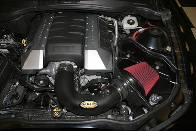

These folks don’t need much of an introduction with the LS crowd because they’re been committed to GM’s new generation flagship V8 since the beginning. “AIRAID offers cold air systems for all popular LSX based applications,” Trent McGee from AIRAID, tells us. “We are continually trying to improve the way our products fit and perform. Our in-house engineering team consists of both mechanical and industrial design engineers using the latest 3-D CAD modeling equipment to produce advanced designs that make power right out of the box.” And this is exactly what you want from a bolt-on cold air system.
A typical AIRAID Intake system consists of a large Roto-molded airbox and oversized intake duct along with a huge washable, reusable air filter available using either oiled or non-oiled filtration technology. AIRAID Intake systems also utilize the OEM mounting points for a quick and easy installation that does not require any cutting or drilling. The beauty of this approach is its OEM demeanor with minimal restriction.

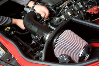

If it is impossible for you to imagine the aftermarket speed equipment world without K&N Engineering, that’s because this forward-thinking aftermarket company has been around for more than 40 years. K&N Engineering started as a small family run business in Riverside, California founded to produce reusable cotton gauze air filters that offered improve breathing above and beyond that of paper element and oil bath air filters. In 1992, K&N produced its first air intake system, which led to many more.
K&N has been manufacturing cold air induction systems for 20 years, and today K&N’s High-Flow cold air systems go through a rigorous testing program before they are approved for sale to the public. What’s more, most of these systems are smog legal.
“All of our intakes are developed on one of three dyno labs we have in house. Once we make the horsepower we’re happy with we then take the vehicle on a 60 mile road trip to make sure all the factory settings are not affected by the prototype K&N intake,” Bert Heck, K&N Intake Manager, tells us. “If everything checks out, we then bring in two or three more vehicles to verify the horsepower gains and that the factory settings did not get affected on these new vehicles. The intake is then released.”
We asked Heck what kind of power gains could be expected from a K&N High-Flow cold air kit, and he replied very practically, saying, “That’s a tough question to answer because each vehicle platform makes different power, though they may have the same LS engine. We have seen is everything from 10 horsepower all the way up to 20 plus horsepower gains, which is very impressive from a cold air kit.”
One area of pride for K&N is their aforementioned commitment to testing and proof when it comes to power. Heck adds, “In today’s marketplace there are some pretty big cold air intake power claims. We don’t make claims – we present the facts, backed up by well documented tests.”

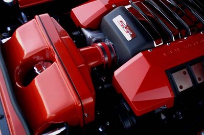

Check out the VR-SC1R Snake Charmer for the C6 Z06 Corvettes. The system is designed to provide maximum gains without tuning or special programmers.

One good example is the VR-SC1R Snake Charmer for the C6 Z06 Corvettes. Vararam designed a front scoop with a raised floor to decrease plenum volume, which will increase the air velocity as it heads to the filter. Then the inlet venturi are raised 1/4-inch and the flange area has been increased for large cubic inch engines.
“Extensive research and development has led to a product that has proven itself to be one of the most powerful ram air system on the market for the Z06 Corvette,” Ledford tells us. “Imagine, 1/4 mile improvements of 3.5 tenths and 3.5 MPH all with no tuning. Simply plug and play. We’ve also noted improvements in fuel mileage with the VR-SC1R.”

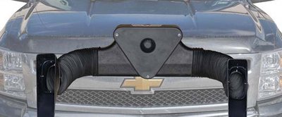

If you’re a 2007-up truck/SUV owner with LS power, you will like the new Vararam Tri-Power ram-air system for Chevy and GMC. The great appeal is how it is designed and engineered because it requires no drilling or cutting. It affords you true ram-air right out front at the leading edge of your truck’s slipstream. Vararam claims 25-30 horsepower increases are possible, without concern for water ingestion.
Vararam’s Tri-Power ram-air system for LS powered trucks and SUVs may yield as much as 20-30 horsepower depending upon your application and state of tune. The Tri-Power design is a great example of just how much variance there can be in design from one company to the next.
